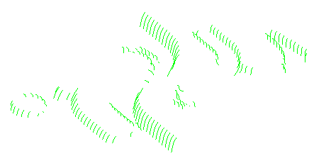

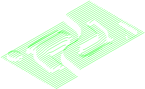

- Click Apply. The two new toolpaths have the same name as the original but have _1 and _2 appended to the original name:
- _1 contains the steep portion:
- _2 contains the shallow portion:
