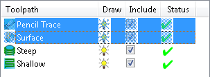

Toolpath table — This displays all of the toolpaths that use the tool and shows whether the tool can machine the part without a collision. The table has four columns:
- Toolpath — This displays the toolpaths that use the tool.
- Draw — Toggle a light bulb on
or off
to draw or undraw the toolpaths on the model.
- Include — Select to include a toolpath in the holder profile calculation.
- Status — This displays the status of the toolpath.
— The tool assembly does not collide with the part during machining.
— The tool assembly collides with the part. The colliding component is shaded red.
— The toolpath profile has not been calculated.

As an example:
- Initially the tool has four toolpaths associated with it:
- Select two of the toolpaths:
- Click
. This leaves two toolpaths associated with the original tool:
and two toolpaths associated with the new tool:
because both create a copy of an existing tool. With
the toolpaths associated with the existing tool are now associated with the new tool. With
all the toolpaths, except for the active toolpath, remain associated with the existing tool.

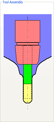

Tool Assembly — This area displays the defined parts of the tool assembly as well as the holder profile.
tool
shank
holder
holder profile
