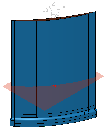

- Click Curve Editor tab > Create panel > Curves > Planar Section. The Planar Section dialog is displayed. The position of the origin point is displayed on the model and the cursor changes to
- Click on the model to define a point which the slicing plane passes through. The orientation is determined using the principal editing plane of the active workplane.

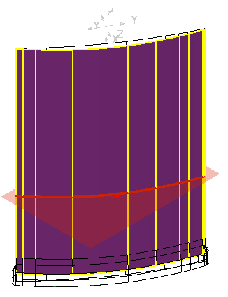

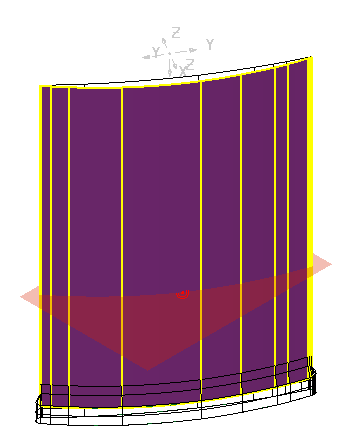

- To select a surface:
- Click
to switch to surface selection mode. The cursor changes to
. - Select a surface on the model. The selected surface turns purple.
- Click
- Enter:
- A Tolerance of 0.01.
- A Surface Joining Tolerance of 10.0.
- Click Preview. A preview of the curve is displayed as a thick, red line on the model.

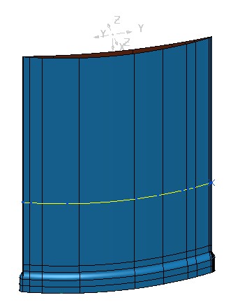

- Click Create. The segments are added to the pattern.
- Click Close to close the dialog. The curve is displayed on the model.
