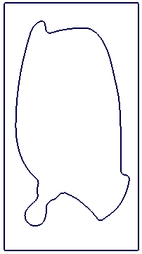

2D round — Select to offset a 2D curve by a specified distance. This creates smooth offsets when offsetting outwards and sharp offsets on internal corners when offsetting inwards.If you start with this curve:
Selecting
2D round gives:
Original curve
Curve offset inwards
Curve offset outwardsThis creates smooth offsets when offsetting outwards and sharp offsets on internal corners when offsetting inwards.
