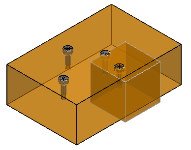

The model below shows a simple assembly called test:
- The bolt component has been created with a main solid and a Power Feature.
- The
block is a single component.
