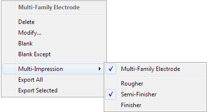

You can also use the tree to define the role of a burn-form (in a Multi-Family electrode) as a rougher, semi-finisher, or a finisher. To define a burn-forms role:
- Select a Multi-Family electrode.
- Right-click the selected electrode
The Multi-Family Electrode context menu is displayed.
- From the context menu select one of the following:
- Multi-Impression > Rougher
- Multi-Impression > Semi-Finisher
- Multi-Impression > Finisher
