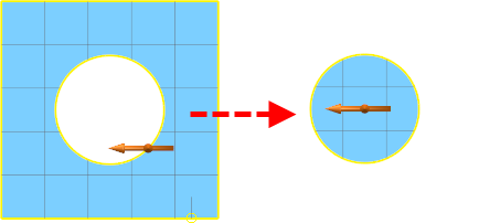

    Swapping the trim region
    This swaps the trim region by switching the visible and invisible regions of the surface.
    1. Select the boundary.
    2. Click on the Trim Region toolbar.
      The trim region is swapped:
