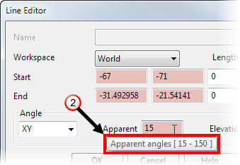

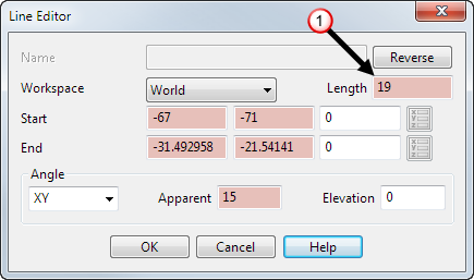

  2. Right-click one of the selected lines, and select Modify.
    The Line Editor dialog is displayed. It is similar to that of editing a single line, with the following differences:
    — The properties that differ between the selected lines are highlighted in pink.
    — The range of values is displayed when you hover the cursor over a property.
