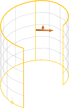

  1. Select a solid, surface or component. For example:
  2. Tip: You can select more than one item.
  3. Click Visualisation tab > Tools panel > Surface Inspection.
  4. Left-click on a position on the selected surface. The surface normal arrow is displayed, and the draft angle and curvature values of the position are displayed below the cursor:
