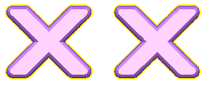

    Using the example symbols below:
    1. Select File >Options > Application Options > Object > Solids to display the solid modelling options.
    2. Select Convert unconnected triangles to single solid.
    3. Select the symbols:
    4. Click Solid tab > From Items panel > From Surfaces/Meshes.

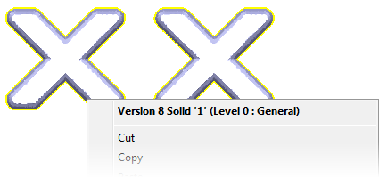

      The two symbols are converted to a single solid:
