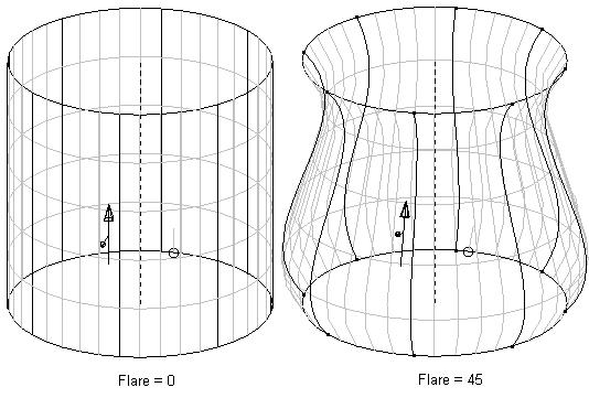

Flare — The flare angle defines the direction of the longitudinal tangent relative to the spine tangent:
If the flare angle is positive, the longitudinal diverges from the spine; if it is negative, the longitudinal converges with the spine.

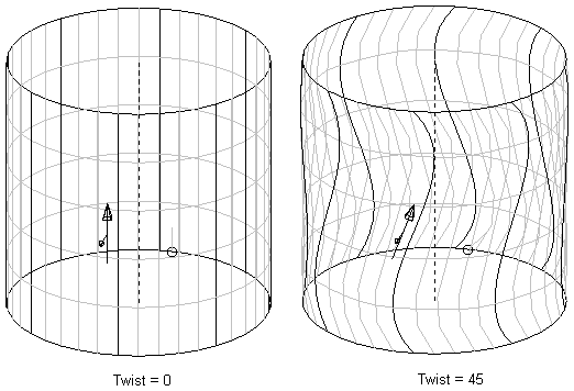

Twist — Twist forces the longitudinal to twist about the spine:
If the twist angle is positive, the longitudinal rotates in a counter-clockwise direction as it passes through the lateral.
