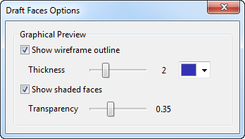

Draft Faces Options dialog
Use the options on this dialog to define how the graphical preview is displayed.
  1. Use Show wireframe outline to specify whether or not a wireframe outline of the draft faces are displayed.
  2. Use the Thickness slider to specify the thickness of the wireframe graphics.
  3. Use the drop-down list to specify the colour of the wireframe.
  4. Use Show shaded faces to specify how the draft faces are displayed.
  5. Use the Transparency slider to specify the transparency of the shaded faces.
