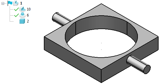

    You can redefine the solid by changing the order of the features in the tree:
    1. In the solid feature tree, select the icon of the feature.
    2. Drag the selected icon onto the icon of the feature you want it to lie below.
    In the tree shown below, we will switch the positions of the cut and boss features:
    Drag the icon of boss feature onto the icon of the cut feature :
    This reorders the features and redefines the solid:
