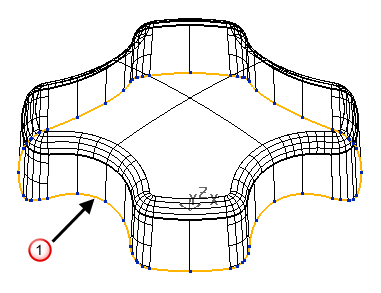

- From the edges of your surfaces, create a composite curve
When you create a composite curve from a surface, the tangent data of the surface is stored with the definition of the composite curve.
- Select the composite curve.
- Click Surface tab > Manufacture panel > Extend.
- Use the Surface Extensions dialog to extend the surface.
