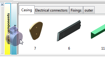

To copy components to another library or category:
  1. Click and drag the component so that the component is hovering over a vertical library tab or a category tab.
    The component library window that is displayed will reflect the position of the cursor:
    • Adding a component to a category:
    • Adding a component to a library:
  2. When the correct library is displayed, release the mouse button.
  3. The component is added to the library.
