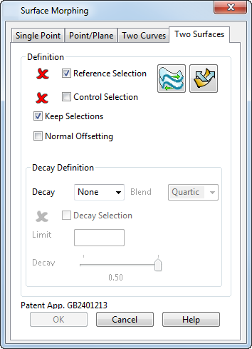

Surface Morphing dialog - Two Surfaces
This uses a control and reference surface to define the morph.
The two-surface method provides more control over the shape of the result than the single point methods. It can be used to make substantial changes to a model, for example to stretch or bend in a controlled manner, or to project one shape onto another.

Two Surfaces dialog
  1. Ensure that Reference Selection is selected and choose the reference surface on the model.
    Note: Use Surface Tools tab > Modify panel > Reverse as required.
  2. Select Control Selection and choose the control surface on the model.
  3. If you want to keep the reference and control surfaces after you have used them for morphing, select Keep Selections.
  4. Select Normal Offsetting so the surfaces to be morphed are bent to follow the control surface.
    See Moving points using the two-surface morphing method, for information on how the selected objects are morphed using Normal Offsetting.
    If Normal Offsetting is deselected, you can specify the Decay Definition options. The options that are used to define the decay are described in Surface Morphing dialog — Two curves.
