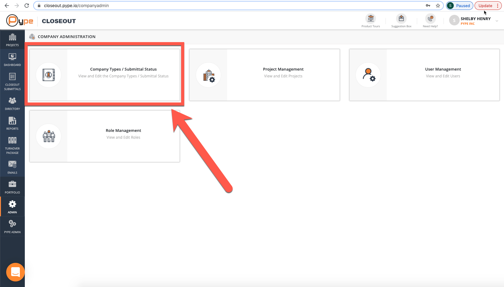

Step 3:
Next, you will select Company Types/Submittal Status.

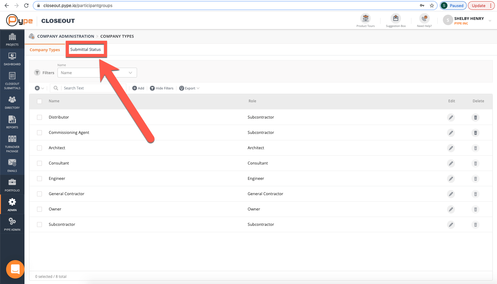

Step 4:
Here, you will select the Submittal Status tab, located next to the Company Types tab.

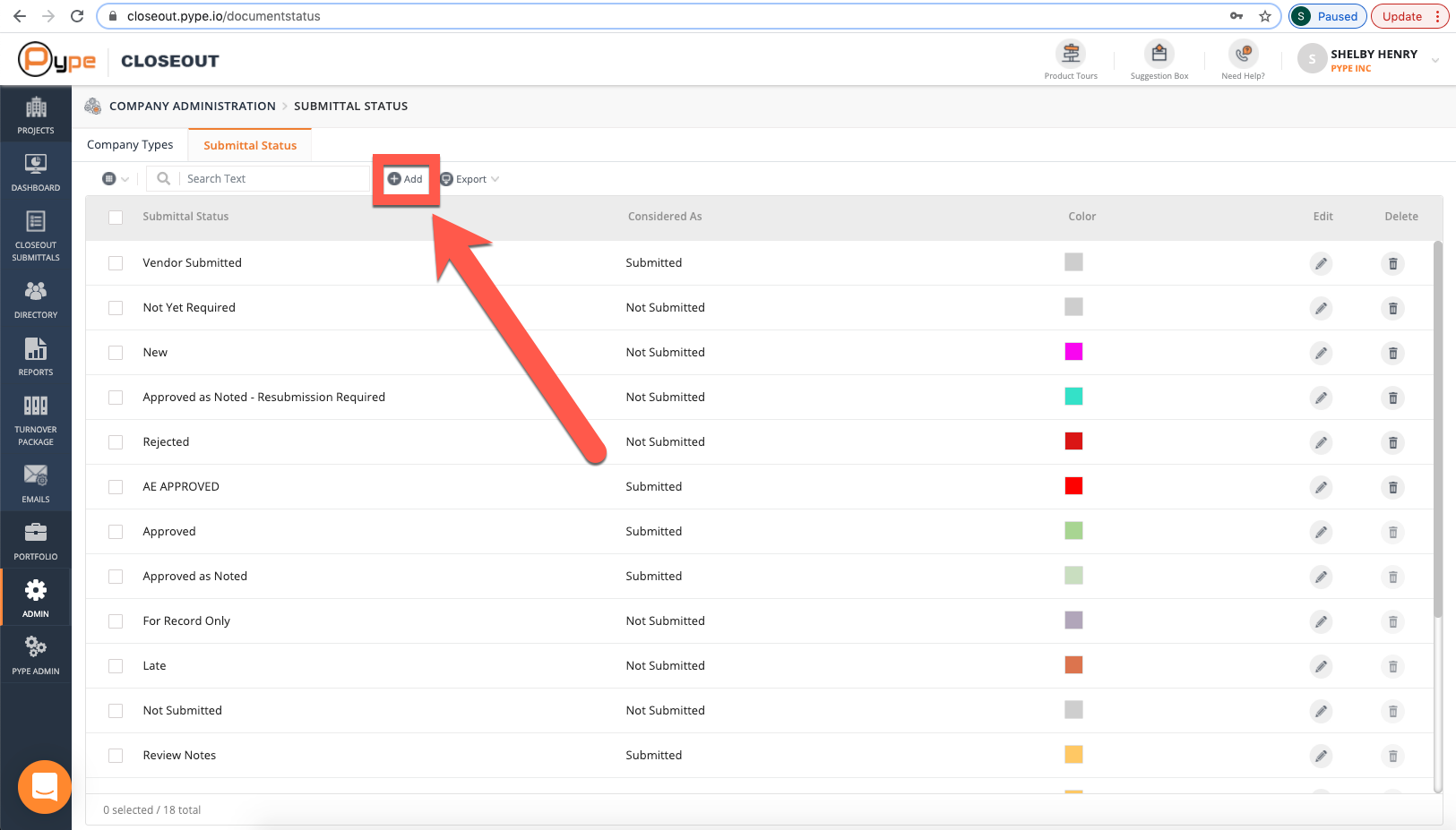

Step 5:
Once you are in the Submittal Status tab, select +Add.

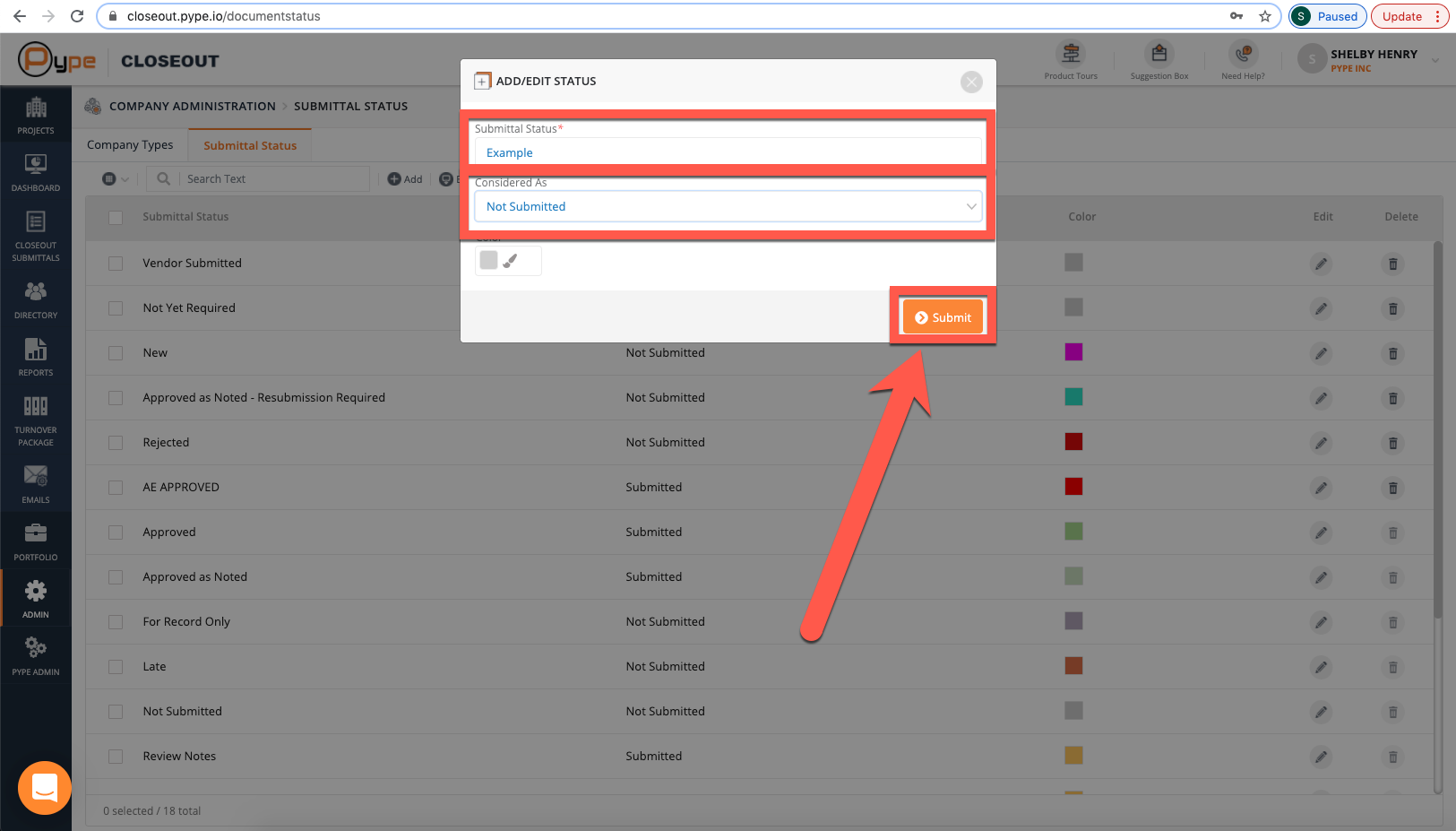

Step 6:
Next, you will need to create a name for your custom submittal status, and then you will need to select whether this status is considered Submitted or Not Submitted. Then, you will select Submit.

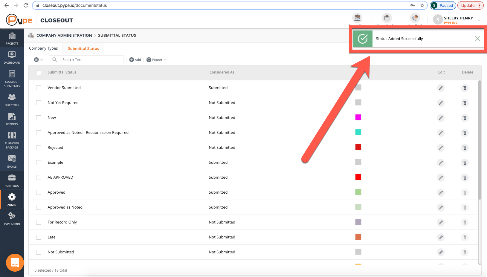

Step 7:
After you select Submit, a notification that says, Status Added Successfully, will appear in the top right corner of the page. You will now be able to assign submittals to this custom status!
