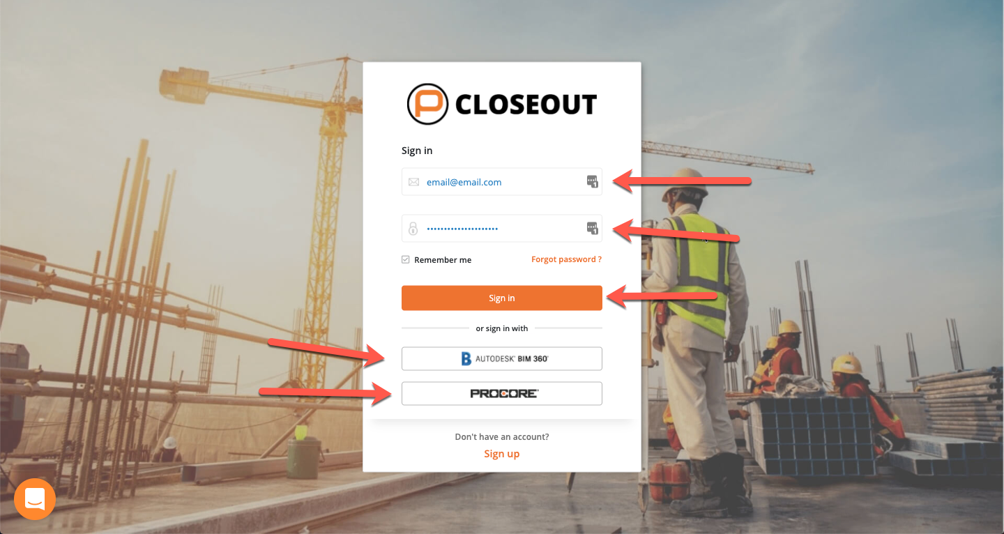

Log in to Closeout

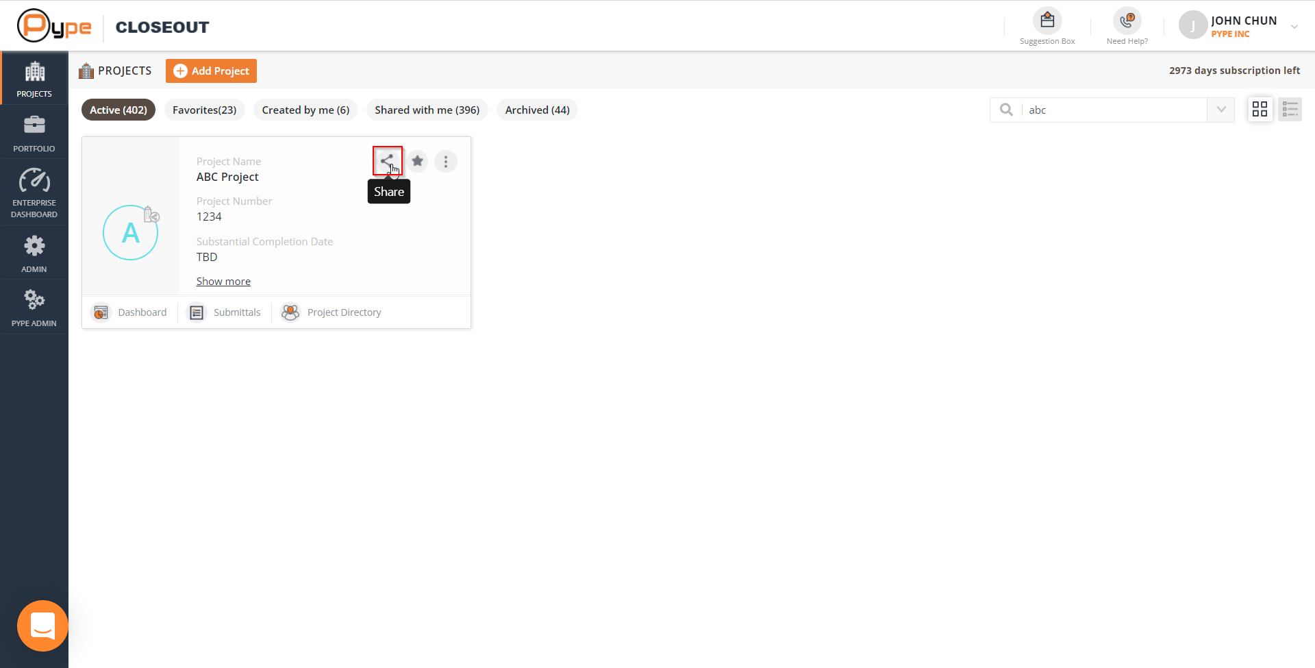

Step 2:
You will be directed to the Projects tab view. Hover over your Project block to reveal the hidden icons and click on the Share icon.
This icon is also available in Closeout Submittals and Directory.

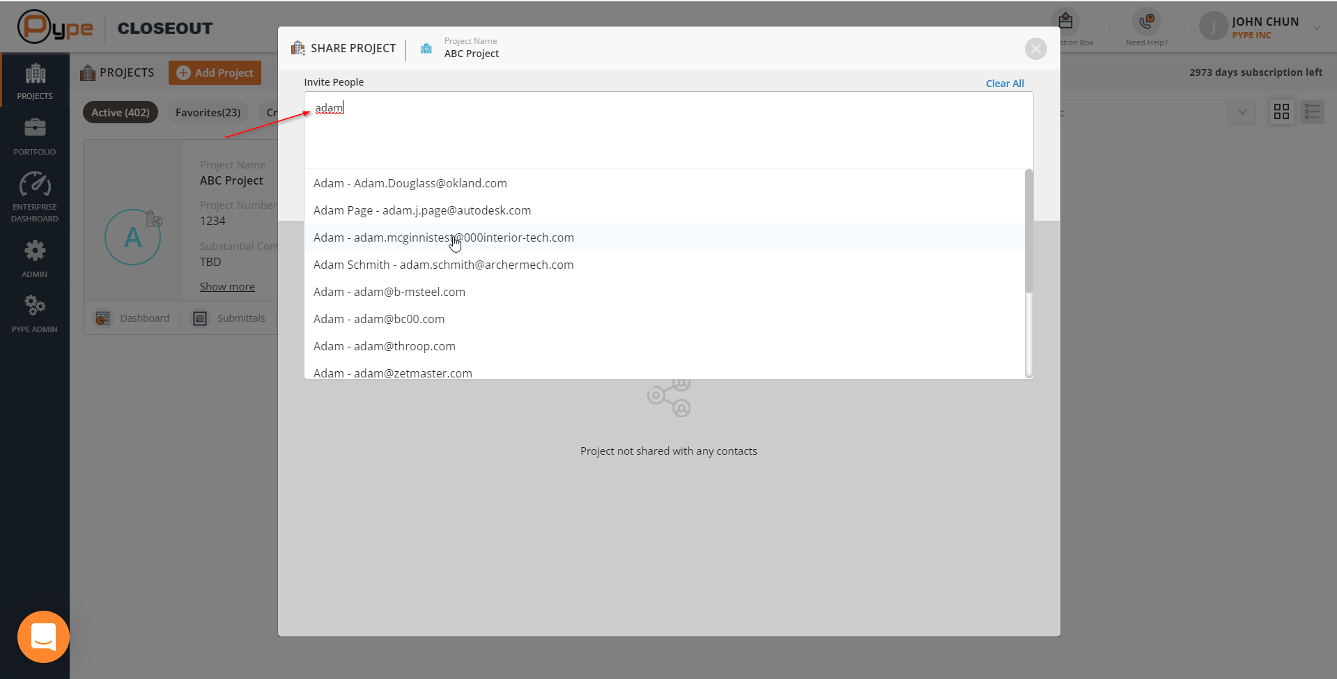

Once you're in the Share screen, you can type in the user's name to search for an existing contact within the Directory. Click on the user's name to add them to Invite People.

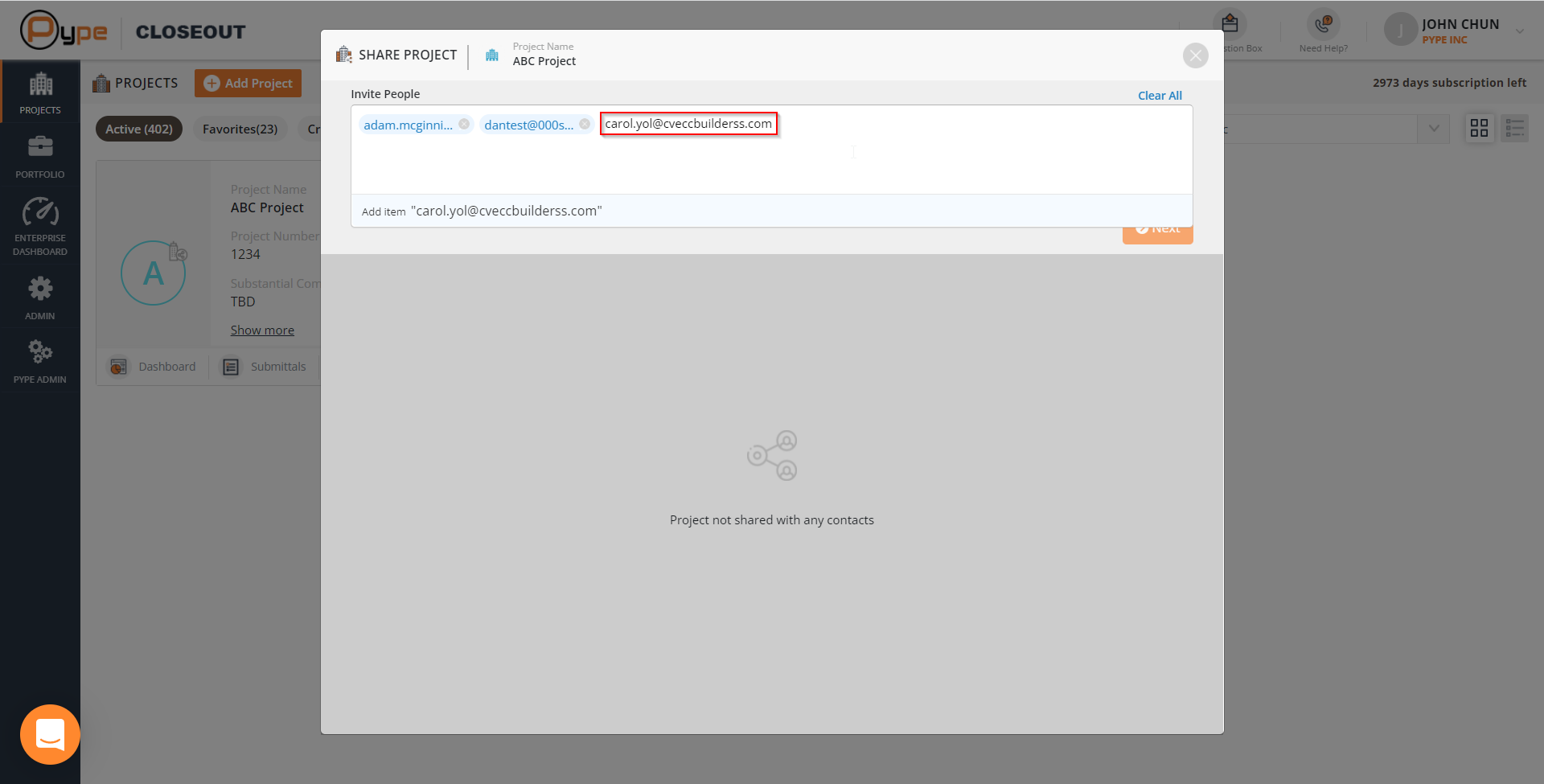

Step 3a:
If the user is not present in the Directory, you can also type in their email.

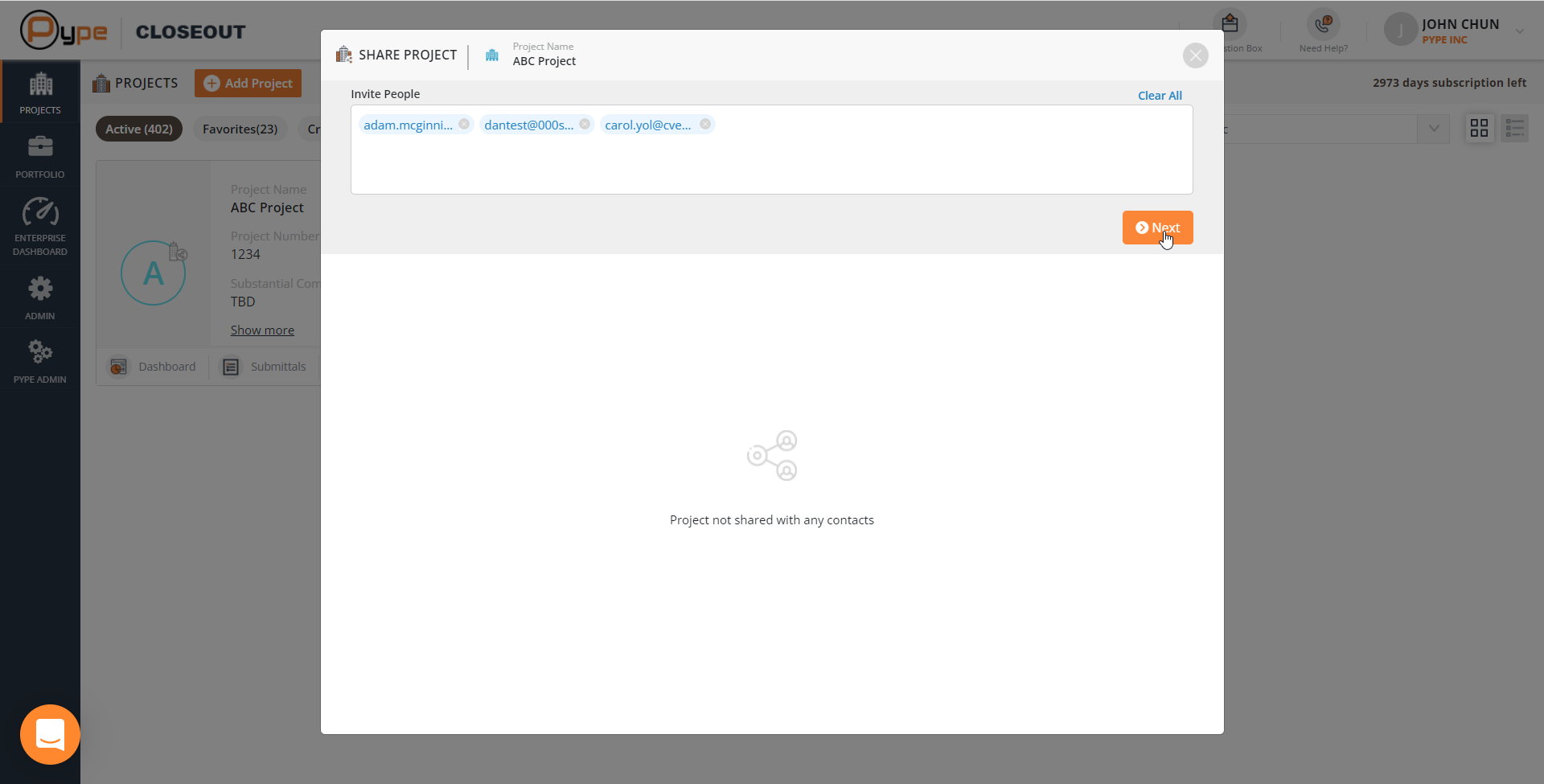

Step 4:
After adding users you would like to share the project with, click Next to move on to the next step.

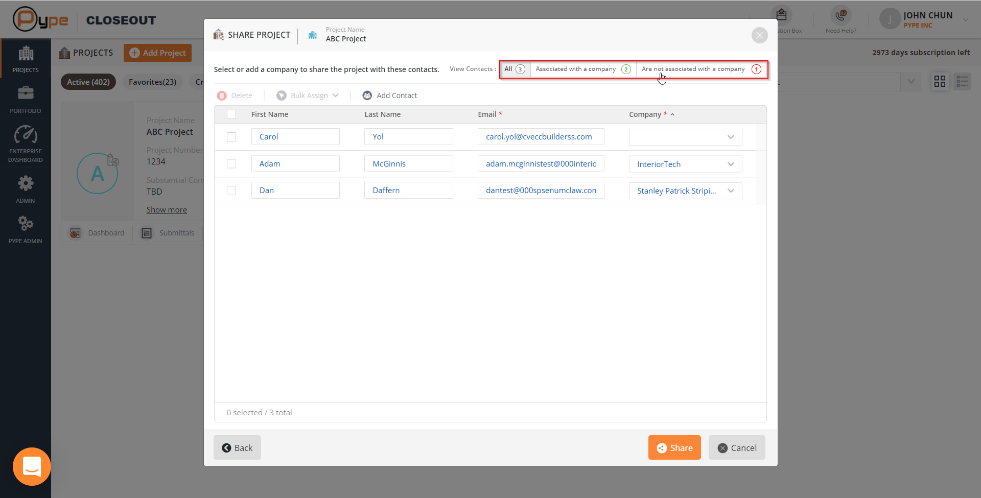

In this step, you can configure user's information before sharing the project. There are two filters at the top you can use to narrow down the list of users (Associated with a company vs. Not Associated with Company)

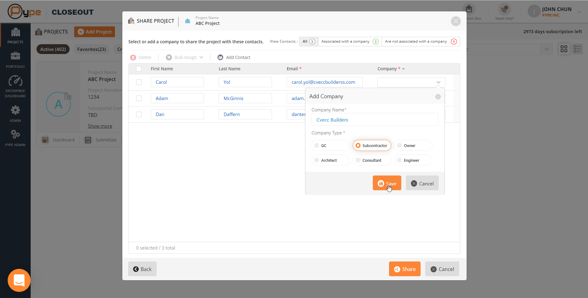

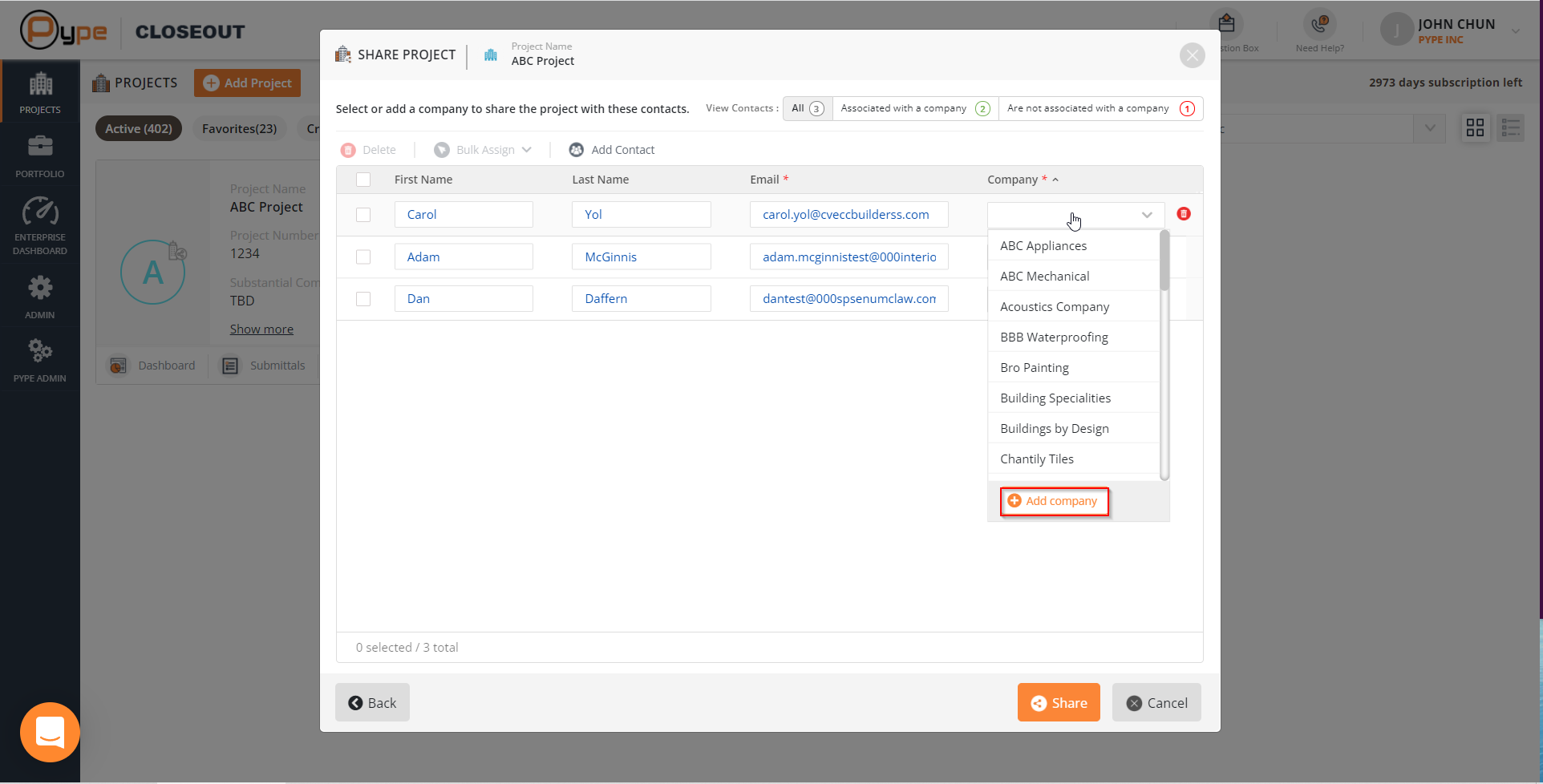

Step 5a:
For users that were added to Invite People by typing in their email, the system will fill in the necessary information for the user, but they will need to be assigned a company either through the dropdown box or by clicking on Add Company.

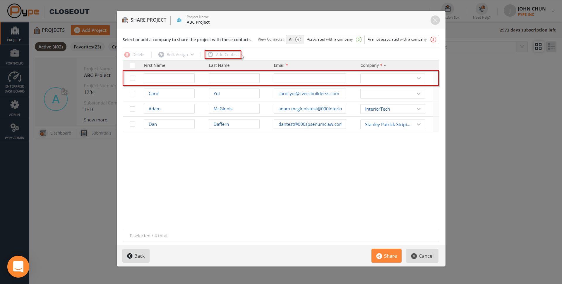

Step 6:
If you would like to add more users to share the project with, click on Add Contact and fill in the required information (Only required field is Email and Company)

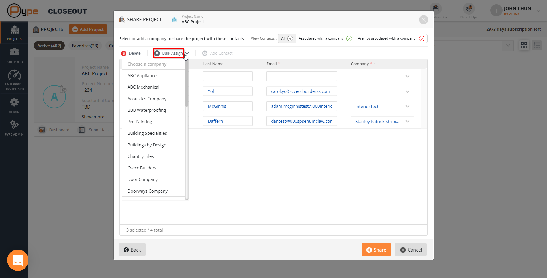

You can also select users then Bulk Assign to update the company field for the selected users.
