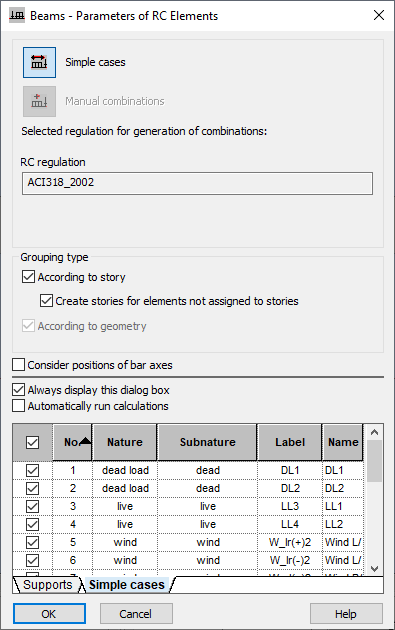

After completing the transfer, Robot displays the Parameters of RC Elements dialog (as in the image below), where you can select combinations, grouping type and so on.
The above dialog displays for RC beams. Other RC element types have their specific dialogs. After you specify and accept the settings in this dialog, the transferred elements are removed from the selection of elements for transfer to RC modules.

Beams/Continuous Footings
Relevant loads transfer to the beam and are not displayed in the Parameters of RC Elements dialog.
In the case of continuous footings, displacements transfer as well as the elastic foundation coefficient Kz.
To enable moving to the RC beam / continuous footing design module, the following conditions have to be satisfied:
- The element must be a bar.
- The element must be assigned a column cross-section.
- The element must be defined as a bar on the elastic ground (this condition applies only to the transfer to the RC continuous footing design module).
In this dialog you can determine the type of loads to be transferred. These are either Simple cases or Manual combinations.
- Select Simple cases to calculate with code combinations according to the regulation of the design of RC structure elements. This is in the *.rgl file in the CFG folder.
- Select Manual combinations to calculate for the combinations defined in Robot. Apart from that, there appears the list of all manual combinations and you may select them.
The Grouping type field contains options that allow you to automatically group elements according to certain criteria (this does not work for continuous footings).
