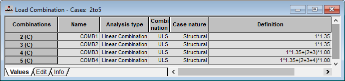

The table includes 3 tabs:
- Values - This tab displays definitions of manual or automatic combinations. To switch between manual and automatic combinations, right-click this tab and select the Table Columns option; in the Combinations dialog select Combination definitions (for manual combinations) or Code combination components (for automatic combinations).

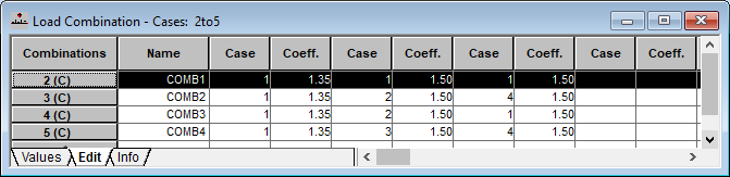

- Edit - Use this tab to modify factor values and load cases that participate in combinations. Note: If a factor is assigned a zero value, the load case to which this factor is ascribed does not participate in the combination.

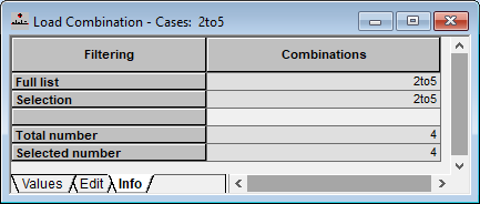

- Info - This tab displays current filters or the selection presented in the table.
