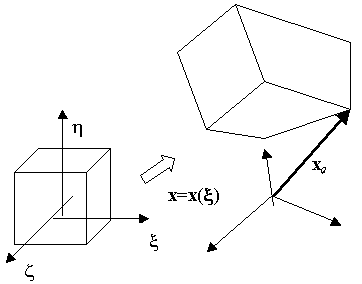

Element geometry is based on isoparametric mapping from a reference element onto an arbitrary element

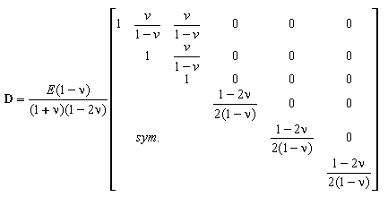

Where e o are imposed strains (thermal dilatation and shrinkage) and D is a constitutive matrix. The constitutive matrix D (linear - elastic isotropic material) is shown as follows:
