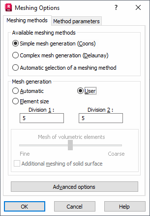

Meshing Options
Clicking Tools menu > Job Preferences (default sets of meshing parameters located in the Meshing tab) or Analysis menu > Meshing > Meshing Options, lets you select meshing methods and parameters.

Meshing methods tab
At the top of the dialog, the Allowable meshing methods field specifies a method for generating a finite element mesh:
Simple mesh generation (Coons method)
When simple mesh generation is selected, the following options are set by default:
  • Available meshing methods: Coons - often, and forcing ratio: recommended
  • Mesh generation: User, Division 1 =5, and Division 2 = 5
  • Coons' method parameters: triangles and squares in triangular contour, and forcing ratio: proposed
  • Finite elements: 4-node quadrilaterals, forcing ratio: recommended.

The Mesh generation field defines 3 meshing types:
  • Automatic
  • User - Defines two parameters of Coons' method: division1 and division2.
    A division parameter for Coons' method, which defines the number of elements created on the second contour edge (between the second and the third contour vertexes). The edge of the contour is automatically divided so that the division corresponds to the first edge contour.
    Note: For triangular contours: the division of the edge between the third and first contour peak is the same as between the second and third peak. In quadrilateral sections: the division between the third and fourth contour is the same as between the first and second peak; and the division between the fourth and first peak is the same as between the second and third peak.
  • Element size - you can define a dimension for an element in the finite element mesh to be obtained after the mesh is generated. For example, if the element dimension is 20 inches:
    • Planar finite element (quadrilateral) mesh, generates a mesh of elements similar to a square, whose side is 20 inches
    • Planar finite element (triangle) mesh, generates a mesh of elements similar to an equilateral triangle, whose side length is 20 inches
    • Volumetric finite element mesh, generates a mesh of elements similar to a cube, whose side is 20 inches.
In addition, this field specifies the type of volumetric finite element mesh to generate: from a coarse mesh to a fine mesh. If you select Additional meshing of solid surface when generating a mesh of volumetric finite elements, a mesh on a solid surface (contour) is also generated. Note when using this option, the volumetric element mesh is finer.
Note: Do not apply Additional meshing of solid surface where the faces of 2 solids meet.
Clicking Advanced options at the bottom of the Meshing methods tab opens the Advanced Meshing Options dialog.
