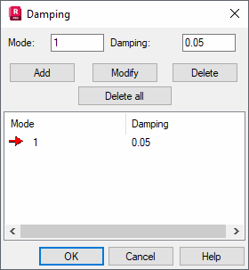

To define the damping value for an eigenmode, Enter the eigenmode number and the corresponding damping value and click Add.
You can also modify and delete active table rows by clicking the appropriate buttons. Click Delete all to delete the defined list of damping.
You can define a value of damping for each mode, or only for selected modes. A value of damping for intermediate values that are not defined on the list, is interpolated based on the specified values. Start and end values are constant. This is shown in the following image.
The following values of damping are used:
  • for mode 3 damping is 0.03 (3%)
  • for mode 5 damping is 0.05 (5%).
Following this principle:
  • damping 0.03 is assigned to modes 1 and 2
  • an interpolated damping value of 0.04 is assigned to mode 4
  • a constant value 0.05 is assigned to the remaining modes - above mode 5.
