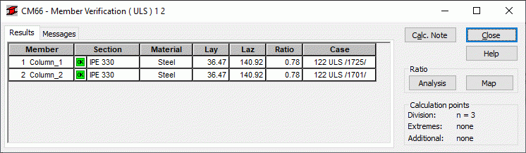

Member / Code Group Verification results
The Member Verification and Code Group Verification dialogs are similar.
The Results tab of the Verification dialog displays the results of the verification or design process for steel, timber, or aluminum members, or group of members.
These short results are displayed in a table.
Each row of the table corresponds to a member or group of members according to the list that was defined.
Results interpretation
  • : The section meets the code criteria.
  • : The section does not meet the code criteria.
