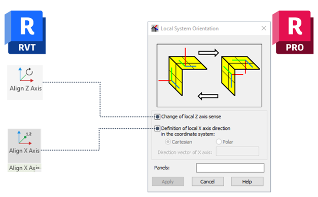

Revit 2025 release introduced local coordinates system (LCS) setting possibilities. They can be set for analytical members and analytical panels. The new LCS definition is transferred to Robot Structural Analysis model.
Another new feature in Revit is the ability to split analytical members. The loads and boundary conditions assigned to analytical members are also split. Revit to Robot link allows bi-directional transfer of these changes.
