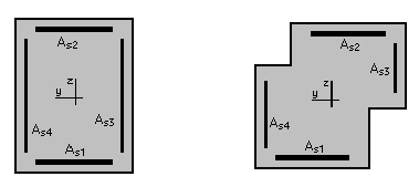

    For biaxially bent columns with the rectangular, T-shaped, L-shaped or Z-shaped sections, areas of reinforcement should be interpreted as follows.
    As1= As2 = Reinforcement along b.
    As3= As4 = Reinforcement along h.

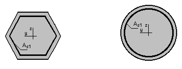

    For columns whose cross section is described by a regular polygon, circle, semicircle or circle quarter, the areas of reinforcement should be interpreted as follows.
    As1 = Reinforcement along b - evenly distributed along the edge.
    For rectangular beams bent biaxially:
    As1= Bottom reinforcement. As2 = Top reinforcement.
    As4= Bottom reinforcement (Z axis). As3 = Top reinforcement (Z axis).
    For elements with reinforcement on both planes, the results should be interpreted as follows.
    The areas are treated independently - they have no common parts in the corners. The corner area of section reinforcement is assigned to the area resulting from shearing in the Y plane.

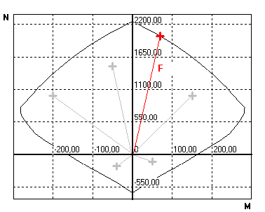

    Note: In the result table a design combination is a combination which yields the greatest section efficiency ratio for the reinforcement calculated on the basis of all the combinations. The following internal forces are presented for the design combination.
The design combination shows the most unfavorable set of forces for a given section. It is only one of the components of the envelope of sets of forces. Yet each of these sets may affect the final required reinforcement area. This is the reason why the design combination as a single component may not be used to design the whole section.
