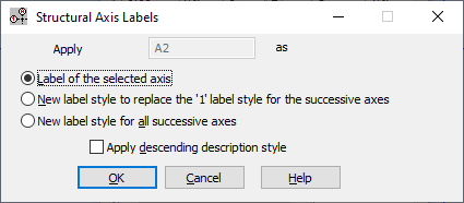

This option lets you change the names of structural axes. After you have changed the name in the Structural axis dialog and pressed <Enter>, the following dialog displays:
This dialog has the following options:
Label of the selected axis
When selected, only the name of the selected axis is changed. All remaining axes names remain unchanged.
New label style to replace 'A' for the successive axes
When selected, the name of the selected axis is treated as a template for defining successive structural axes whose names contain the string < xxx>. The names of successive structural axes are changed according to the new user-defined template.
New label style for all successive axes
When selected, the name of the selected axis is treated as a template for defining names of successive structural axes. The names of all the successive structural axes are changed according to the new user-defined template.
Apply descending description style.
When selected, the names of successive structural axes are arranged in the descending order.
