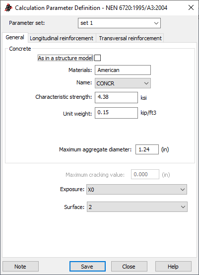

The General tab of the Definition of calculation parameters dialog box for NEN Code:
Concrete parameters are defined 3 ways.
  • When the As in a structure model option is selected, needed material parameters are assigned from the data used for static calculations of structures.
  • Giving a concrete grade from a provided list.
  • Defining the fck value of concrete resistance.
The following parameters can be defined.
  • Cracking value.
  • Redistribution coefficient.
  • Coefficient of concrete creep.
At the bottom of the dialog, Reinforcement control (EC2 4.4.2.3) checks reinforcement for cracking.
