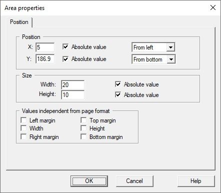

Area/table properties
The Area properties or Table properties dialog box presented below allows you to determine parameters of a defined area or table. The dialog box can be opened when you select an area or table and
  • select the Edit > Properties command from the menu
  • press the Properties icon .
The Position tab contains the same options as the corresponding tab in the Text properties dialog box. Additionally, you can determine the size of the view and indicate which values are to be independent from page format (in the default configuration, all the values are recalculated proportionately by the Robot printout module when page format is modified).
An additional Orientation option is available in the dialog box for defining table parameters.
