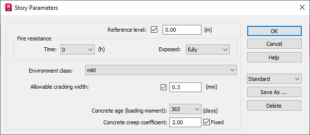

The Story Parameters dialog allows you to define parameters of a story according to the Indian (IS456:2000) code.
Access
Select RC Design
Provided reinforcement layout, and then create a new RC element or open an existing one.
- Click Analysis
Story Parameters. - Click
(Story Parameters).
Dialog elements
- The following options describing a story are available:
- Reference level - a level of the top surface of a beam; it is an additional parameter in a beam drawing,
- Fire resistance - parameters used to check the minimum dimensions of an element and the required cover:
- Time (0, 1/2, 1, 3/2, 2, 3, 4)
- Exposed (fully, 50%, one face)
- Environment class - the parameter used to check the required cover,
- Admissible cracking width - to enter a admissible cracking value,
- Concrete age (loading moment) - the parameter used in calculations of the long-term deflection,
- Concrete creep coefficient - the parameter used to automatically calculate the creep coefficient.
The Save As option allows you to reuse a set of story parameters. This set is saved to your current user directory. You can reuse this set for the other element in the Story Parameters dialog or assign it to the selected element (or selected elements of the same type) in the RC Component Inspector.
The Delete option allows you to remove the selected set of story parameters.
