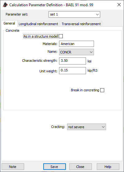

The General tab of the Definition of calculation parameters dialog box for BAEL code:
Concrete parameters are defined 3 ways:
  • When the As in a structure model option is selected, needed material parameters are assigned from the data used for static calculations of structures.
  • Giving a concrete grade from a provided list.
  • Defining the fc28 value of concrete resistance.
If an element is ascribed with break in casting concrete, select Break in casting concrete.
The following parameters are available.
  • Cracking: permissible, limited, not permissible cracking
  • If seismic dispositions are considered, select the Seismic dispositions option.
