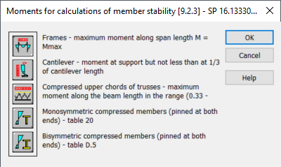

Use this dialog to define additional parameters of stability analysis for bent members for the Russian code SP16.13330.2017.
Access
- Click More in the Member Definitions - Parameters dialog, and then click one of the moments icons.

Dialog elements
The options included in this dialog enable defining schemas of bending moment distribution along the length of an analyzed element. This information is applied in stability verification of elements subjected to simultaneous action of compressive force and bending moments (see point 9.2.3, Table 20 and Annex D).
