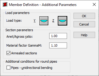

Additional Parameters (DIN)
Use this option to define additional code parameters for the steel bar type. Access the parameters by clicking the More button in the Member definition - parameters dialog.
Used this dialog to define.
  • Load type for directions Y and Z.
  • Section parameters - you should specify.
    • Anet/Agross ratio - this value applies to a tensile force acting on the cable. It is a coefficient that defines the relationship of the member cross-section area, not considering the bolt or rivet openings (Anet), to the total cross-section area (Agross).
    • Material coefficient GammaM.
    • If the section is to be annealed or not.
  • Round pipes case conditions. If the Unidirectional bending of pipes option is selected, then, for this type of section, a bending moment equal to a sum of moments operating along axis Y and Z is calculated; the resultant moment is the basis for bar design.
