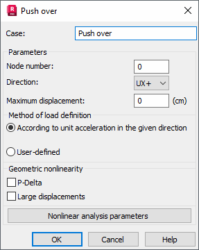

Case
The name of the load case.
Parameters

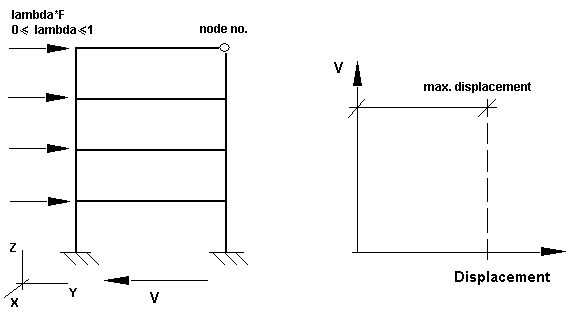

  • Node number - The number of a structure node belonging to the structure roof (see the figure below).
  • Direction - Direction of an external factor affecting the structure in the global coordinate system.
  • Maximum displacement - Maximum displacement in the selected structure node.
Method of load definition
  • According to unit acceleration in the given direction - Determines a displacement vector during the pushover analysis.
  • User-defined.
Note: The According to unit acceleration in the given direction option uses the following algorithm.
  1. Calculation of the vector , where K, M - stiffness matrix and mass matrix, respectively, Idir - unit direction vector; Φ dir - push mode vector.
  2. Normalization: , where .
  3. Definition of mass participation factor: Γ dir = (M Idir , F dir).
  4. Definition of lateral forces as: Fdir = γdir M Φ dir , where γdir is a scalar multiplier.
The right-hand side of the equation system presented in point 1 can be defined with a static load case that will make up a set of forces applied to the structure. The algorithm of calculation of lateral forces (points 2, 3, 4) is identical to that described above.
Geometric nonlinearity
  • P-Delta - Select this option to consider P-Delta effects during the analysis.
  • Large displacements - Select this option to take into account large displacements and/or rotations during the analysis.
  • Nonlinear analysis parameters - Opens a dialog which allows you to set up the options of the nonlinear analysis.
