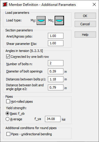

Use this option to define additional code parameters for the steel member type. Access the parameters by clicking the More button in the Member Definition - Parameters dialog.
The following parameters are defined:
  • Load type parameters in the directions of axes Y and Z
  • Section parameters
    • Anet/Agross ratio which applies to a tensile force acting on the cable. It is a coefficient that defines the relationship of the member cross-section area, not considering the bolt or rivet openings (Anet), to the total cross-section area (Agross)
    • Eta parameter
  • Parameters for angles in tension
  • Parameters for pipe sections (yield strength)
  • Round pipe case conditions. If the Pipes - unidirectional bending option is selected, then, for this type of section, a bending moment equal to a sum of moments acting along axes Y and Z is calculated; this resultant moment is the basis for member design.
