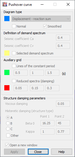

The dialog lets you select 1 of the following types of diagrams:
  • Displacement - reaction sum (when selected, all options in the dialog are unavailable)
  • Capacity spectrum
  • Damping - period (effective) (when selected, all options in the dialog are unavailable)
The options: Normal and Smoothed are available only for the Capacity spectrum diagram. Selecting the Smoothed option results in smoothing the diagram that is displayed.
In the Definition of demand spectrum field, you can determine the demand spectrum (spectrum of ground movements during an earthquake). The demand spectrum is defined using the seismic coefficients Ca and Cv. (See code ATC-40 Chapter 4.) Selecting the Selected demand spectrum option displays a diagram created out of the intersections of the constant period lines with the appropriately calculated reduced spectra.
The options in the Auxiliary grid field include:
  • Lines of the constant period - Selecting this option displays constant period lines. Values entered in the appropriate fields must be positive.
  • Reduced spectra (damping) - Selecting this option displays the reduced spectrum grid. In the available fields, you can define damping values falling in the range of <0, 1>, that are applied to determine the reduced spectra. Entering 0 denotes a damping value of 0%; whereas, entering the 1 indicates a damping value of 100%.
In the Structure damping parameters field, you can define 2 types of structure damping:
  • Internal (viscous)
  • Histeretic (structure behavior type)
For the histeretic damping, the structure type (A, B, or C) is selected. The parameters Beta0 and Kappa (applied to calculate the effective damping) are calculated by Robot and are displayed in the proper fields on a gray background. You can also specify these values if the Other option is selected. The fields for Point1 and Point2 become available. Values of the Beta0 and Kappa coefficients must be positive.
After defining the enumerated parameters and clicking Apply, a relevant diagram is displayed.
