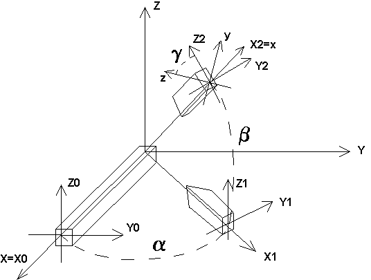

    The angles: ALPHA, BETA and GAMMA, shown in the following image, indicate positive rotations about an axis in the global coordinate system for a structure bar. The ALPHA angle represents a rotation about the Z axis, BETA about the Y axis and GAMMA about the X axis.
