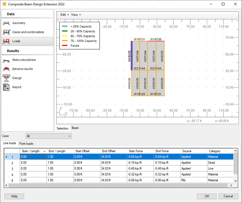

Use the Loads tab to review definitions of load cases from the Robot model.
  1. From the Case list, select a load category.
    It displays load cases corresponding to the selected category on the Line loads or Point loads tab, depending on how a load case is defined.
    Select All to display the full list of loads in the model.
  2. Select the Beam tab in the graphic viewer and review each load case and combination.
    Each load case you select in the table is visualized in the graphic viewer.
