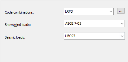

Use these parameters to set up which loads you want to use for your project.
Access
  • Expand the Design codes section in the left panel of the Job Preferences dialog, and then select Loads.
Dialog elements
The appropriate national codes may be chosen for:
  • Code Combinations- click the arrow to select the codes for generating code combinations.
  • Snow/Wind Loads - click the arrow to select the codes required for Snow/Wind Load design.
  • Seismic Loads - click the arrow to select the codes for seismic analysis design.
Click (...) to run the code combination regulations editor.
Note: The codes available in the drop-down lists depend on the country selected in the Preferences dialog. To configure the list of available codes, click the arrow, and then click More at the bottom of the list.
