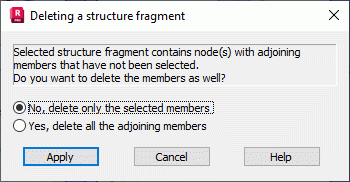

Deleting a Structure Fragment dialog
Use this dialog to specify if you want to delete all the adjoining bars of the selected section.
Access
  • Click and drag to select an area on the structure, and then click Edit Delete.
Dialog elements
No. Delete only the selected bars.
Removes only the highlighted bars from the structure . The adjoining nodes and bars are not removed.
Yes. Delete all the adjoining bars.
Removes the selected bars along with all their adjoining nodes and bars.
