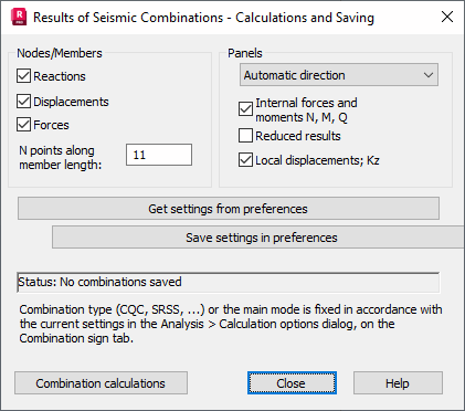

There are two options for saving quadratic combination results:
  1. Automatic saving is activated after seismic analysis calculations. This requires frequent, time consuming processes of static and dynamic calculations set in the Job Preferences dialog.
  2. Select Analysis > Save Seismic Combinations to reduce calculations to at least one.
Select result types to be calculated for seismic analysis combinations in Nodes / Bars and Panels.
  • Click Get settings from preferences to select the default settings from the current project.
  • Click Save settings in preferences to transfer current settings to the Job Preferences dialog.
Click the Combination calculations button to start the calculation process and save the selected seismic combination results. If results for certain groups have been previously saved, they will not be saved again and calculated results may not be deleted. If you turn off saving the previously calculated result while the save status is active, close and reopen the dialog, this result type will be selected again.
The exception being, if you change result parameters, then it is required to recalculate selected results.
After calculation, either of the following status notifications display:
  • Combination results saved displays when the calculation process has successfully completed and results for seismic combinations have been saved.
  • No combinations saved displays when the calculation process has not run, been interrupted, or results for seismic combinations have not been saved.
