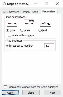

Click the Parameters tab in the Maps on Members dialog, to select the manner of presenting maps on structure members.
The dialog contains the following options.
  • Map descriptions lets you decide how to present the descriptions of the quantities on maps.
    • none - Descriptions in maps of the quantities in the Maps on members dialog are not displayed
    • labels - Descriptions in maps of the quantities in the Maps on members dialog are displayed as labels showing values at the selected points on members
    • text - Descriptions of the quantities in the Maps on members dialog are displayed as values at the selected points on members
    • labels without maps - Only descriptions (in the form of labels or text on members) are displayed for structure members, without maps of a selected quantity.
  • Map thickness lets you define a digit, which determines the ratio of the line used when displaying a map to the thickness of a line when displaying structure members.
