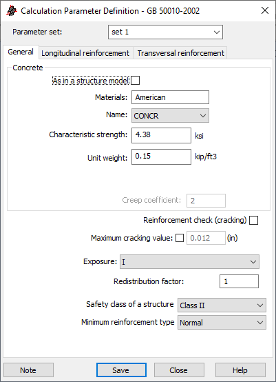

The General tab of the Calculation Parameter Definition dialog box for the Chinese code GB 50010-2002:
Concrete parameters are defined 3 ways.
  • When the As in a structure model option is selected, needed material parameters are assigned from the data used for static calculations of structures.
  • Define the value of concrete strength Fck.
  • Specify from the list of available concrete classes.
Reinforcement check checks the reinforcement due to cracking.
The following parameters may be defined.
  • Exposure (the allowable crack width changes depending on which exposure is selected).
  • Redistribution factor.
  • Safety class of a structure.
  • Minimum reinforcement type.
