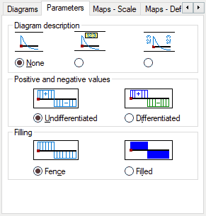

    On the Parameters tab in the Stress Analysis - Structure dialog, you can select the manner of presenting stress diagrams.
    Specify display parameters:
    • Diagram description - indicates the manner of presenting value descriptions on the diagram
      • None
      • Horizontal
      • Vertical
    • Positive and negative values - specify whether to differentiate colors applied to positive and negative values of the presented quantity
    • Filling - determines the manner of diagram filling
      • Fence
      • Filled
