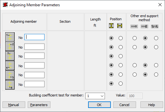

Adjoining Member Parameters (6 bars)
To define the parameters of adjoining members when calculating the buckling coefficient of the main member, double-click , in the Buckling Diagrams dialog.
Enter the following information for the main member:
  • The number of the consecutive structural members (the section of the selected structural member is automatically entered); enter the member number in the appropriate field or select the member on the screen.
  • Position (placement) of the member in the structure; two methods are possible: vertical or a horizontal .
For several codes (ADD8, Eurocode3, NEN6770/6771, PN90) another parameter is included: the support method for the other end of the adjoining member. The available support types for the opposite end depend on the selected steel code requirements.
Once the adjoining member of a selected number is in place, the buckling coefficient value is displayed in the lower portion of the dialog. The value of the buckling coefficient is displayed in the Test for member: Value field once the adjoining member number is selected.
To manually define the parameters of adjoining members, press the Manual button found in the lower part of the dialog. The manual definition of adjoining member parameters is displayed on the screen.
To define parameters of varying inertia members, press the Parameters button, and enter the information on the additional dialog.
