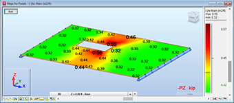

- Model a slab (set preferences, contour definition, properties definition, supports definition, mesh definition).
- Load case definition (self-weight and surface loads such as: uniform planar load, uniform planar load on contour, and linear load).
- Structure analysis and results (linear static analysis, display slab results on maps, and in tabular form).
- Calculations of the Required (Theoretical) Reinforcement Area (set the calculation options, display the maps of required reinforcement area, display the map of deflection, display results of required reinforcement in tabular form).
