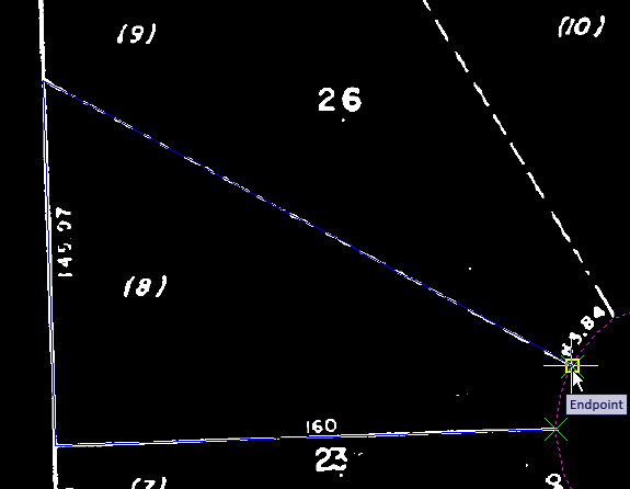

- Pick a point on the lot line between parcel (7) and (8).
- When the follower reaches the end of the lot line, enter
d (Direction) then pick a point along the back lot line to specify the direction to trace the polyline around lot (8).
The Direction option is typically used at decision points.
- When the follower reaches the intersection between the back line and the dashed lot line, enter
d then pick a point near the beginning of the dashed lot line to continue to trace the polyline around lot (8).
- When the follower reaches the cul-de-sac, enter
v (Vector), then pick the edge of the cul-de-sac to specify this as the vector line to follow.
The Vector option allows you to follow a vector polyline when lines or boundaries overlap.
- When prompted, select the beginning and end vertices of the curved polyline. The beginning is the upper vertex; the end is the lower vertex, where the polygon can be closed.
These points specify the direction and distance to follow on the vector polyline. The AutoCAD Endpoint OSNAP is activated for these point selections.
- Enter c to close the new polyline.
- Press
Enter to remove the raster from behind the new vector and exit the command.
The lot lines for Lot 8 were converted to a single polyline.
