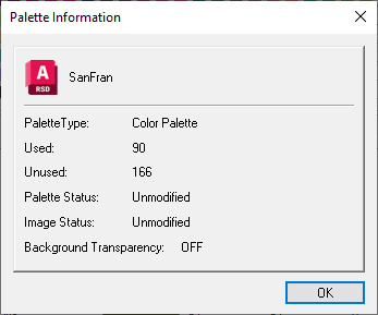

  3. In the Palette Manager dialog box, click Palette menu Information. The Palette Information dialog box shows that only 90 of the possible 256 colors are being used and that background transparency is not activated for this image. Click OK.

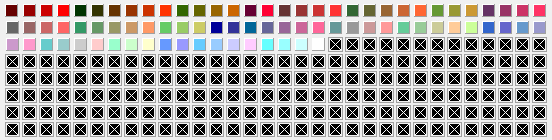

  4. Click View menu Show Unused. The unused colors in the palette are marked with an X through them.

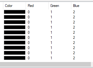

  6. In the Sort By list, select Luminance. The palette display reorders with the darker colors at the end.
  7. Place the cursor over the last (darkest) button in the color table, with an Index of 0. In the status bar, the Frequency is 0, indicating that this color is not used in the image.
    The color at Index 0 seems to be a good choice for the transparent color but you should verify that there is not another index in the image that uses this color.
  8. Click the Index 0 button in the color table. Scroll to the bottom of the list window. The Index 0 line is highlighted and none of the other dark colors in the list exactly match the RGB and Frequency values. This indicates that black is a “safe” color to use as the transparent color.
