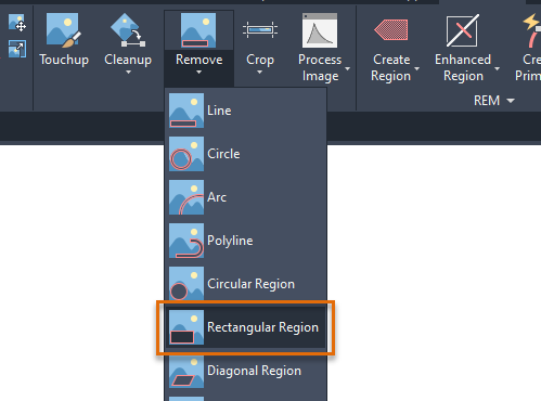

On the ribbon, click Raster Tools tab Edit panel Remove drop-down menu Rectangular Region.
Click and draw a rectangle around the Mandrel Rib Plate and its title block, then click again to rub the region.
