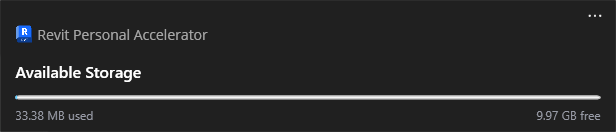

With the Revit Personal Accelerator installed and running, you see this icon in the Windows system tray. Click on the icon to display a pop-up dialog with details on the amount of disk space currently allocated for the Revit Personal Accelerator cache (stored in the PacCache folder) and how much of that storage space is currently available.

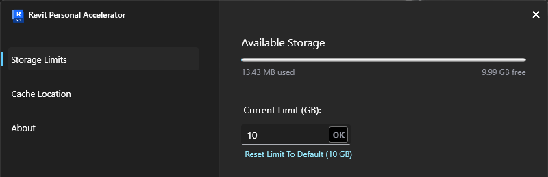

  • Storage Limits: Here you can view the same Available Storage details as well as change the Current Limit value. The Current Limit default value is 10GB, which you can increase or decrease in whole number increments. The minimum allowed value is 1GB and the maximum allowed value is determined by the size of the disk drive where the PacCache folder is stored. Click the "Reset Limit To Default" button to quickly reset the Current Limit to the default value.

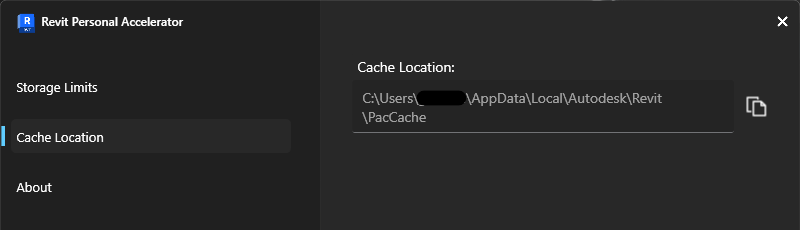

  • Cache Location: Here you can view the PacCache folder location and copy that path to the clipboard so you can easily navigate to it in Windows Explorer if needed.

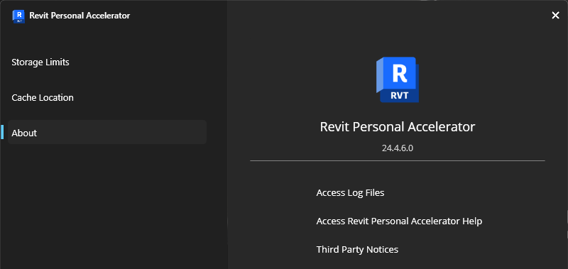

  • About: On this page, you can find the currently installed version number, access diagnostic log files for troubleshooting issues, access this help document, and view Third Party Notice information.

When the PacCache folder has free space available, the system tray icon and Available Storage bars display blue. When the PacCache folder is full, they change to yellow. This is simply a warning that you may want to increase the Current Limit value if you are experiencing slow performance on models you are actively working on. No changes to the model contents are lost when the cache is full and there is no need to manually clear the cache.
